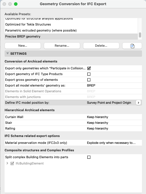

I have specified in my IFC Translator the use of the Survey Point
However on export IfcMapConversion and ifcProjectedCRS are not present.
Any suggestions?

Hi @mitchSyd ,
Could you please attach the problematic IFC in this thread in a zip so that I can have a look at it?
Did you export it as IFC4? Because the above mentioned entities are not available in the IFC2x3 schema.
Zoltán Válé
GRAPHISOFT Product Manager
Zoltan Vale
I have checked the issue, seems that if you save 4.3 schema IFC from AC29 then these don't get exported. It is a bug, I have entered to our database and we should fix it asap, for an upcoming hotfix.
Until then if you save IFC4 then the required entities will be there even from AC29.
