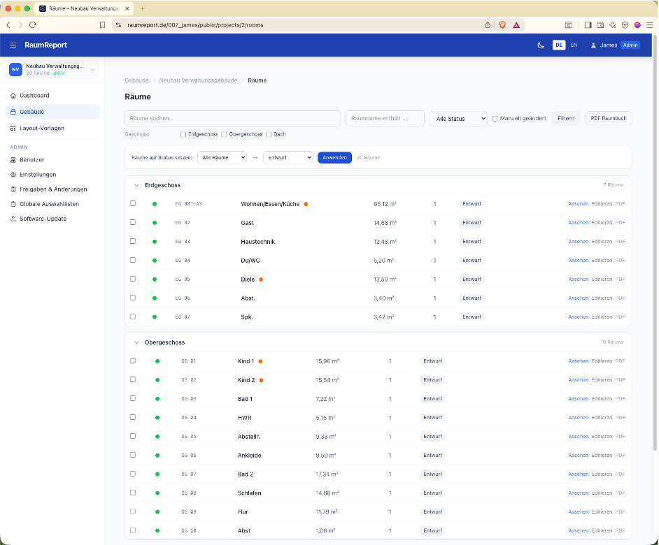

"RaumReport turns the room data of an Archicad model into a professional, collaborative room register - without anyone other than the designer having to open Archicad. The application runs in the browser, data is uploaded once via Tab text export from Archicad, and from then on the entire project team works on the same database. Changes from the room register can be written directly back into the Archicad model via a Python script - the bidirectional workflow is the core of this project."

  • TAB text import from Archicad - the interactive schedule is read in directly, RaumReport automatically recognizes the column structure via suffixes ([BI] for built-in properties, [P] for user-defined, [GDL] for GDL parameters, [H]/[H1] for section headers)
  • Delta import - manually overwritten values are retained during reimport, conflicts between model and room register are detected and can be resolved per field

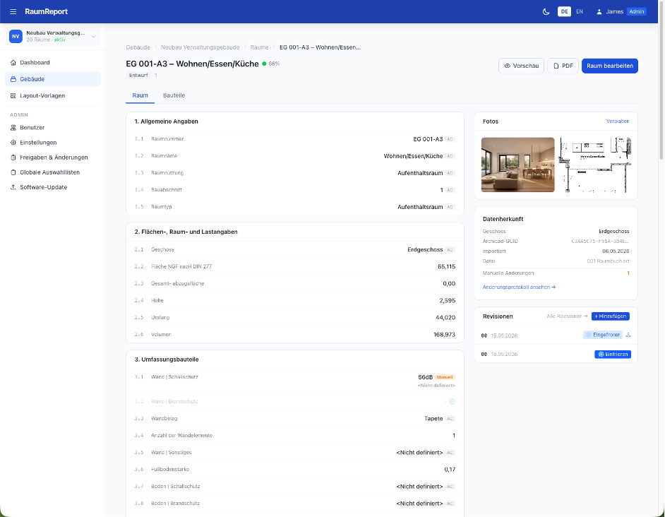

  • Bidirectional connection with Archicad - via an automatically generated, self-installing Python script, changed values are written back into the model, GUID-based and only actual changes are updated
  • Component import - windows, doors, objects and light sources are captured per room and can be edited individually, with syncing the information back to Archicad
  • Multi-user workflow with four roles (admin, editor, specialist editor, viewer), field-level approvals, comments and complete change log
  • PDF export with configurable layout templates, cover page, table of contents, revision overview and closing page
