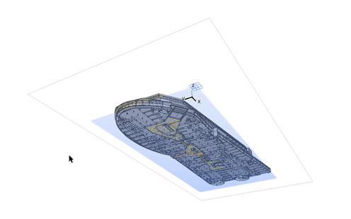

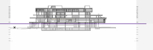

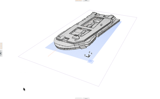

I  am fairly new in Archicad and I am not able to get what (I think) it's a easy result:
I would like to extract to a 2D workplace the section shown by the 3D cutaway.
I have checked a couple of tutorial and posts, but I cannot get a new 2D workplace with the desired view
I have also tried to add a new section from an existing View, but when I get the new Section Workplace, it is empty with nothing visible.
Any tip?

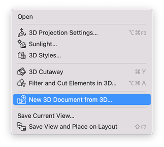

You can also create a 3D document from an axonometry top view (3D cutaway activated):
But from your description, I believe Barry's recommendation will be more suitable.
