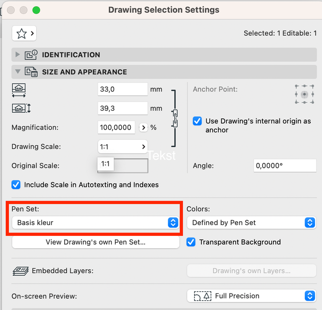

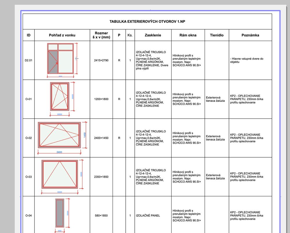

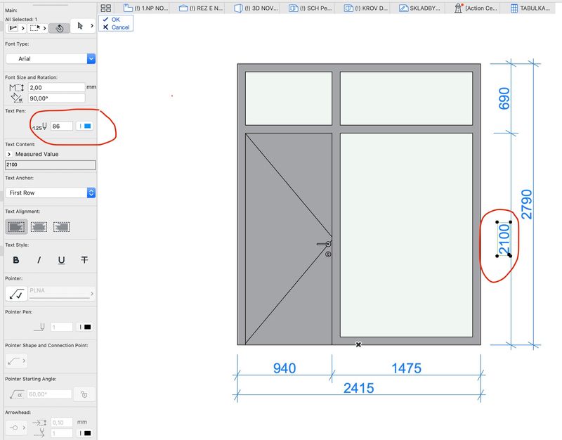

When i drag the shedule to layout. The contures and lines ind 2D/3D views turned red. Also dimension are red.
It's not a View settings thing
Also it has nothing to do with renovation although it is a new door and is it's so classified
Can by a Issue Manager thing?? I dont use this funcion.
Thanks for help!

It is possible to change/overwrite this in the layout: Select the drawing in the layout and change the pen in the drawing selection settings:
Apple M1 Max 32 GB Ventura
AC27
PeterN
Thanks for the info, but that's not the case. The pen set is the same also in layout - drawing settings.
I would be suspecting a Graphic Override or Renovation Filter setting in the view settings.
But then why is the schedule looking OK if it has been opened using that same view?

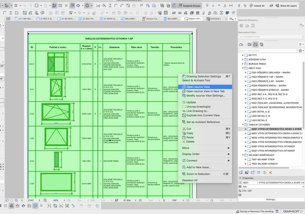

What do you see when you right click on the drawing in the layout and 'Open Source View"?

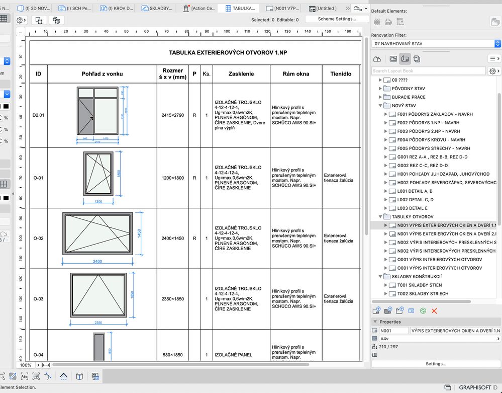

In the project map it is OK. It will only change when I drag it to the layout.

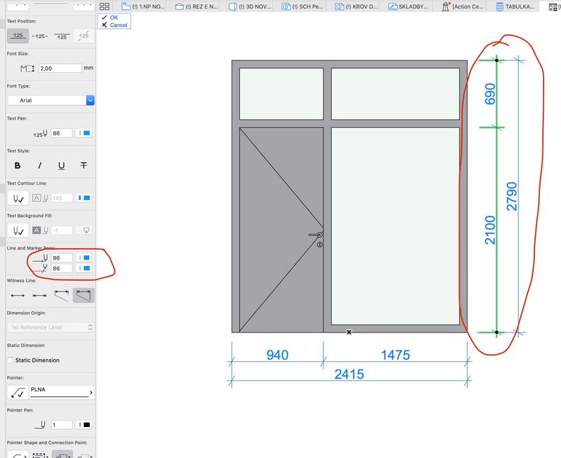

Looking closer it can't be an override, because the dimension text is still blue, but the lines are red.
I am not sure what else it could be.

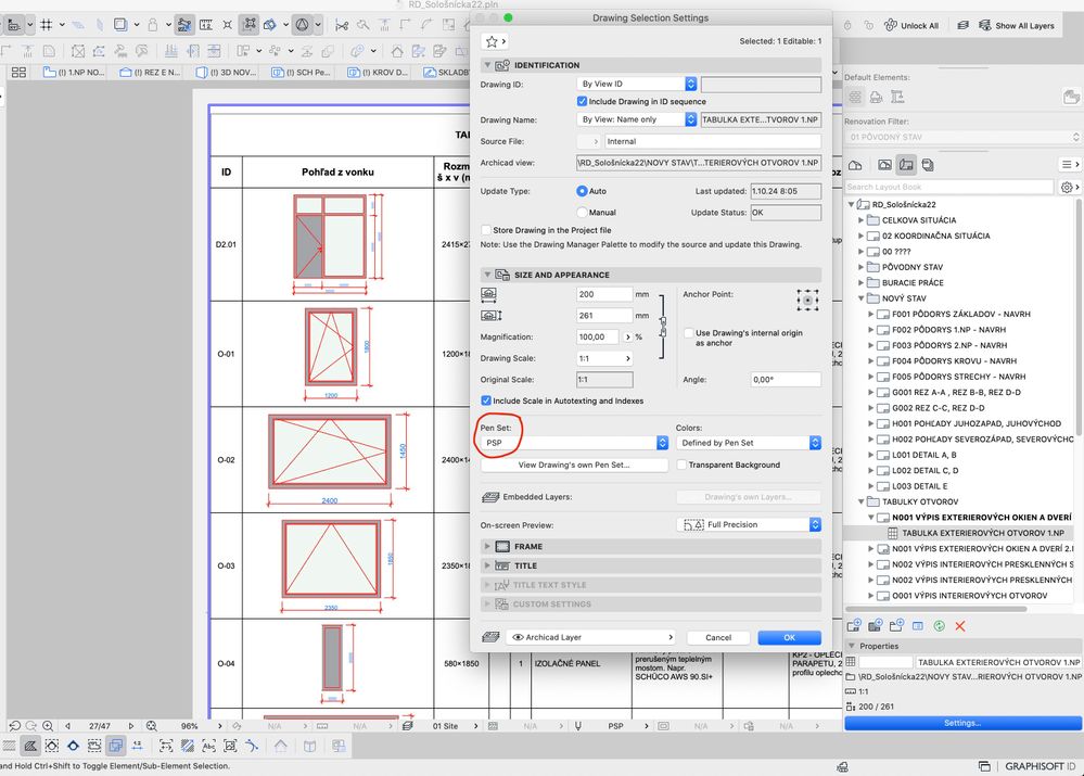

No, its not pen override. The pen set is the same!
and the pen color of the dimension and text line is the same!

This sounds like a bug to me. Archicad is infested with bugs like this.
I would try to make a copy of the schedule, open some other view (eg. a plan view) so that current view settings are not the same as with the old schedule, create a new view for the new schedule and then add it to the layout.
Can you try the following?
1. Remove the placed Drawing from the Layout.
2. Go back to the Floor Plan.
3. Set Graphic Override to "No Overrides".
4. Switch to the Layout's TAB.
5. From the View Map, drag the Schedule View onto the Layout.
Does it still display those lines in red?
