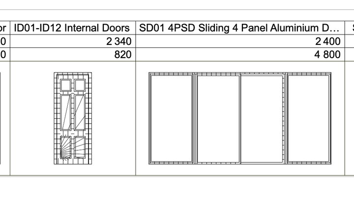

Hi, as my title indicates, I have some 2D views of my doors and windows in my schedule displaying unwanted extra lines. Some horizontal lines in elevation view of my doors or windows showing up and down the side of the frame. I also have some vertical lines going along the bottom and top of my window frames. Also on my internal doors I have lines radiating out at different angles.
Since it is not occurring on all my windows and external doors, is it because I have used some older library part doors and windows or is it something else ?

That looks to me like the hatching on a surface material.
Check the Graphic Override and Renovation Filter in the view settings for that schedule view.

Could you show an image?
mthd
Hey Barry, he are the pictures in the schedules.
mthd
That was it.
Thanks again for your help, much appreciated.
