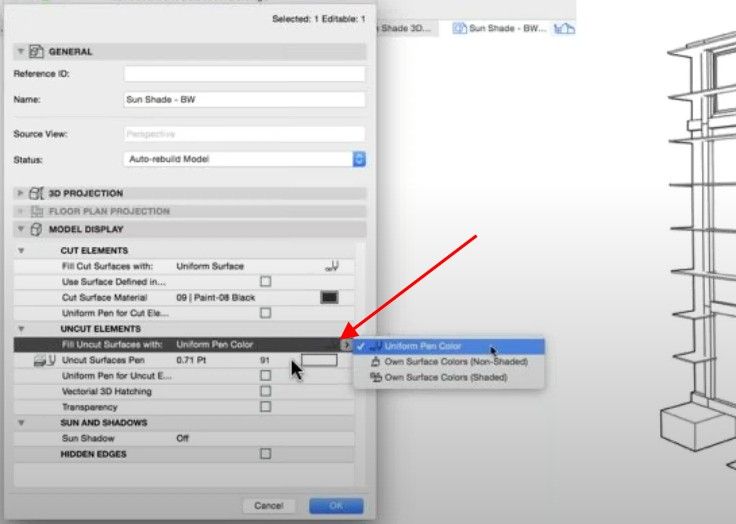

I would like to add a shading function for 3D objects in documents using textures
1 REPLY 1
cuba
It is not possible to make 3d documents with textures.  This is only available for orthogonal views (elevations & sections).
Workaround is to save a 3d view.  Right click in the 3d view to change the settings.
An export of a 3d view has low resolution, if you need a higher resolution you'll have to put a camera and save the camera as a view. Set the resolution in de viewsettings of the camera.
minimal resolution (150dpi) for A3 = 2480x1754 pixels high resolution for A3 (300dpi) = 4961x3508
