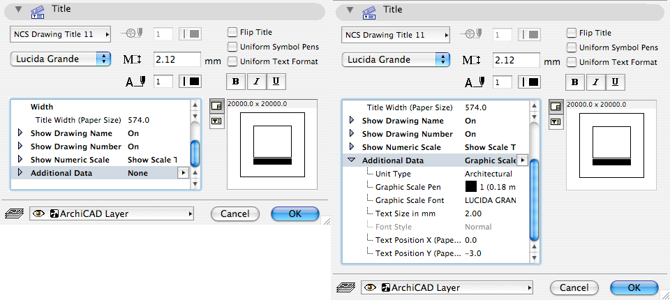

I just converted an AC 10 project to AC11, everything seems pretty smooth except that the Graphic Scale on all of my drawings disappeared. It's not very obvious but they are still in the Title.
Under the last item in the Title section of the Drawing Selection Settings under Additional Data, change the pop up Menu from None to Graphic Scale (This is on the right, not the heirarchical arrow on the left).
You will also want to change the text position Y to -3 mm (or adjust to your liking)

Are you able to change the Graphic Scale's font?
Doesn't work for me.
