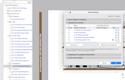

This is a "cosmetic" Bug but since the introduction of the Transmittal feature and  Action Center there is no way that you can have an Updated Set. This also happens with Publisher.

Yup, the magic roundabout.
Last time I tried to resolve this I had the drawing manager open and the Ground Floor plan was persistent in setting the "Needs Checked" flag. I have noticed that just prior to publishing, Update runs again anyway. Perhaps the persistent NC flag on a member of the transmittal set is a way of forcing a final update.  Whatever the reason the updating process needs reviewed to stop us wasting so much time trying to establish a complete update.
