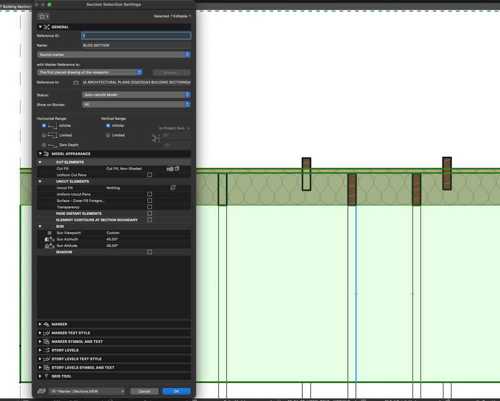

I am seeing this issue as well in sections. A beam (used as roof rafter framing) set within a composite pitched roof does not show its cut fill. Instead archicad shows the outline of the cut beam with a transparent background, i.e. the cut fill of the roof shows through the beam. The behavior is inconsistent (some items show up randomly with cut fills). I have double checked section settings, graphic overrides, building material strength, etc. and nothing has corrected this. It would be great if there was a setting I was missing, but this sure seems to be a bug.

The intersections of Roofs and other element types do not clear based on Intersection Priority of the Building Materials by default:
https://help.graphisoft.com/AC/27/INT/index.htm#t=_AC27_Help%2F040_ElementsVB%2F040_ElementsVB-270.h...
Select the Beam and the Roof and use the Connect > Merge Elements command of the context menu. Then the priority-based intersection will be performed on them.

Lazlo, thanks for your reply on this as well as the link. Much appreciated. I will give this a try and hope this solves the problem for now. I’m still confused as to why some of the roof joists show with cut fills in the section and others do not. I will double check these roof joists to see if they are already merged with the roof.
All said though, that help article shows how complicated these intersections are for what should be a really straightforward action. It seems to be another example of Graphisoft over-complicating things in the software. I’m trying to imagine a scenario where just using building material priorities for beams and roofs would be problematic when it comes to these element types intersecting, and just can’t see one.   But again, thank you for the workaround.  Hopefully all will work out.

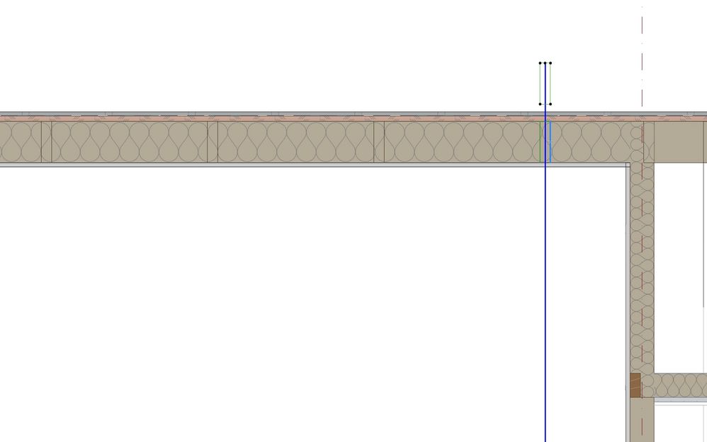

Thanks again for your input. The merge does in fact work to create the cuts properly which I suppose is a good enough workaround if we have our structural members modeled within the roof element (as they would be in real life) and want their cut to show properly in section.
However, the odd bit is that prior to merging the beams, when the beams intersect a roof element I am seeing some of these beams show up with their cut fill shown somewhat properly (certain lines of the roof still show inside the cut fill of the beam), while other beams show their cut fill as transparent, i.e. the roof cut fill shows through the cut of the beam. See attached screenshot showing the roof with none of the beams merged yet.
I might be missing something, but I still see this as an odd behavior/a bug in the software. Maybe it's just a function of an older graphics card on my end. The only other post I have seen on this is here: https://community.graphisoft.com/t5/Modeling/Complex-profile-beam-cut-fill-showing-weird-in-AC26/m-p... .
Wondering if someone at Graphisoft might have something to add?
