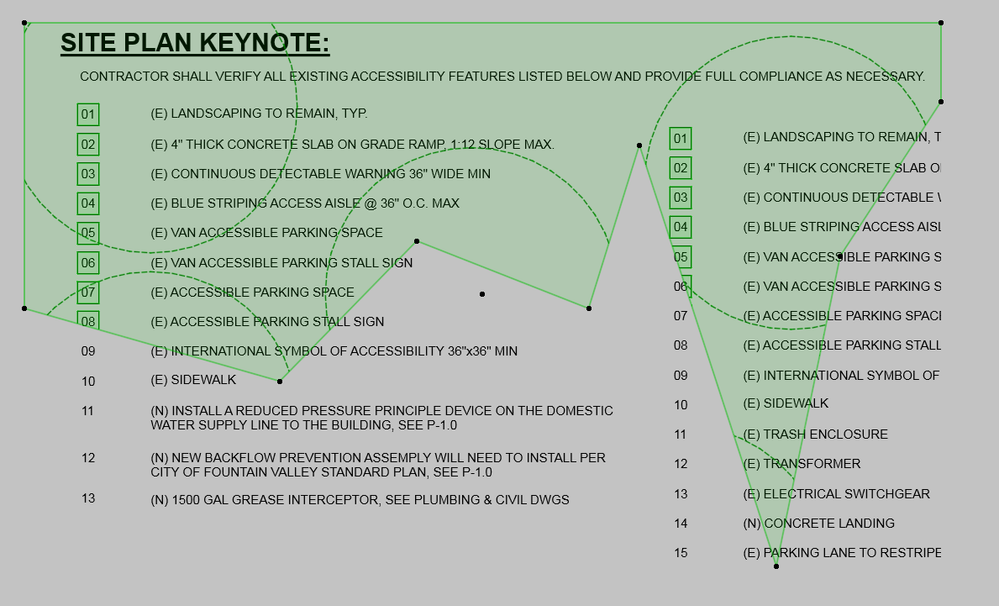

Is this a bug?  Does anyone have this issue?  Text box does not crop and show through the crop lines, while all other graphic info is cropped as intended.  This only affects display and not published pdf.

I have same issue.
josealonsofs
I have the same issue too
This is supposedly fixed in the latest 27.2.1 update.
Texts are no longer visible outside of the cropped view area on Layout. (DEF-16604)
