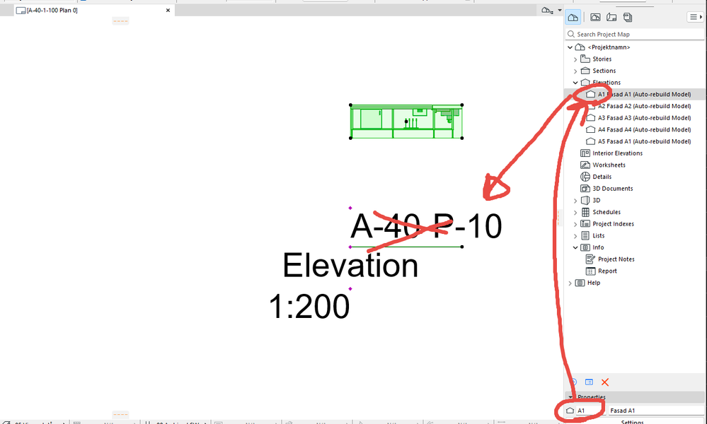

I'm looking for a title block for elevations/section that can show elevaton/section ID as well as name? If yes...shareable?

Hi Miha 🙂
The Titleblock in the elevation/section marker....

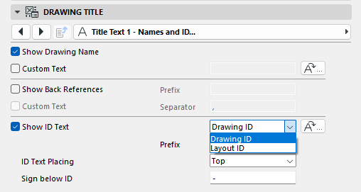

A title block for a layout-placed section/elevation drawing is what I see in your screenshot. The basic AC drawing title can display the Drawing ID OR Layout ID and Drawing Name, but not the Layout Title.

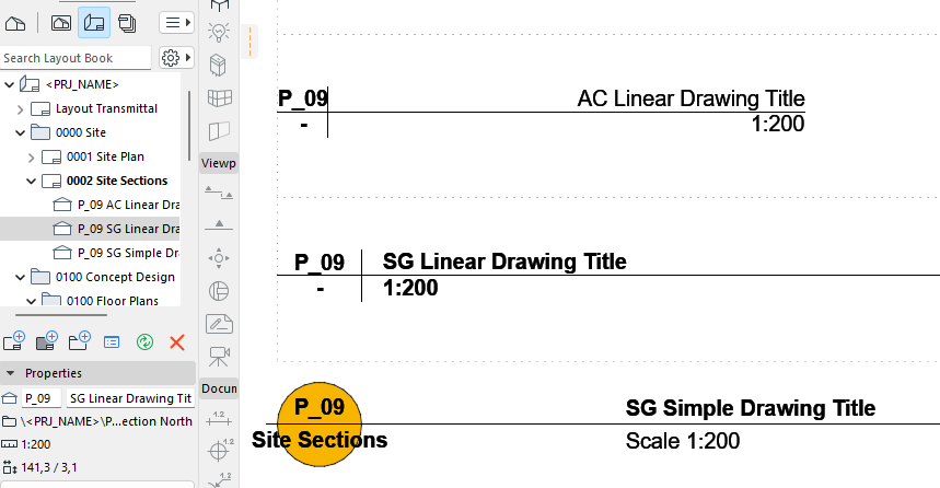

You might want to check the GS SG website. SSA Downloads – Graphisoft Singapore
You can find some extra goodies there which are available via a GS ID and among them are also some interesting title blocks (and markers), which can display the Drawing ID, Drawing Title and Layout name.

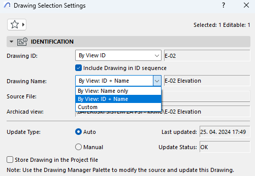

One more thing I forgot - in the Drawing Selection Settings you also have, under Identification, the option to swich the Drawing ID (by View ID or by Layout ID) and Drawing Name (Name Only or ID+Name).

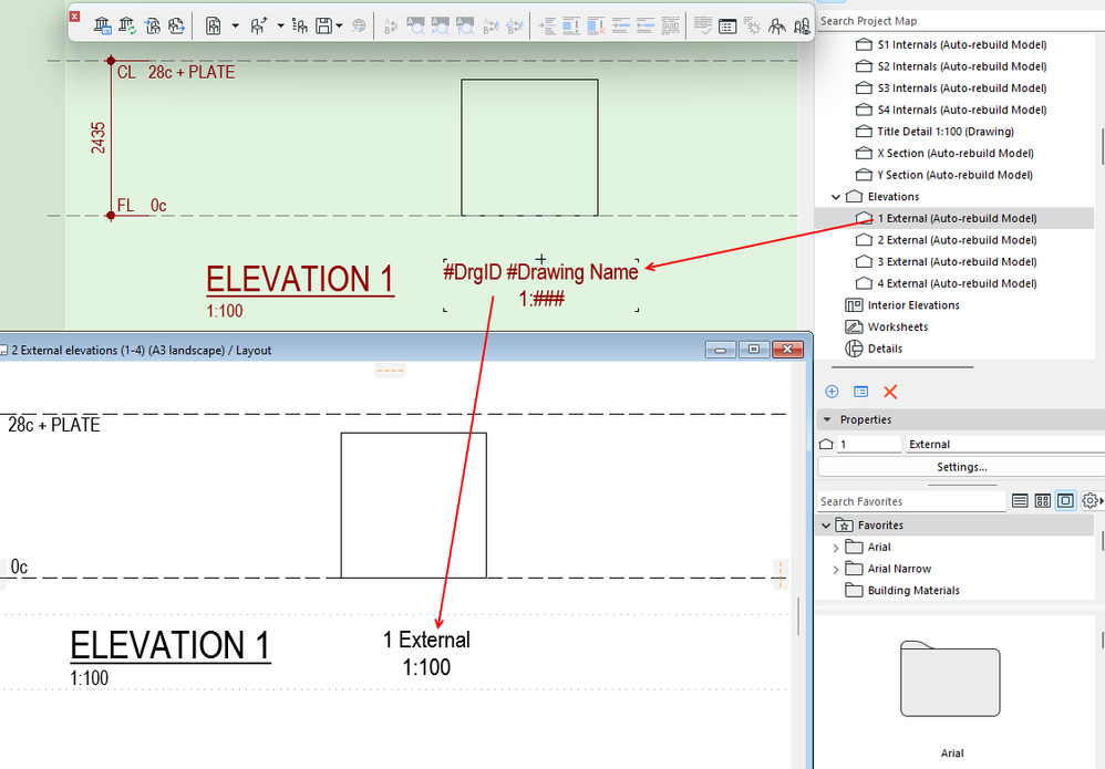

What about just using Autotext?
It won't look correct in the actual section/elevation, but will be correct on layouts.
The one on the left in my image is just an object where you can type what you want, the scale part is automatic.
