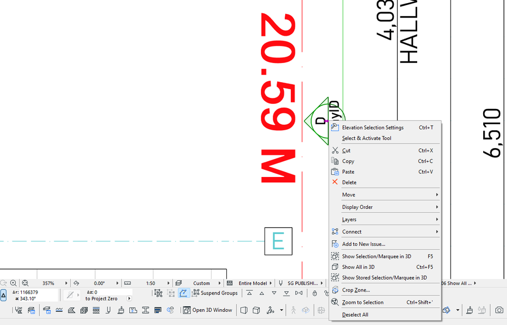

ArchiCAD wiped out Elevation & Section Views. This happened when I create a detail blow-up from elevation and create a view on view map. Then, I found all of my elevations and sections are gone but the markers are on plan. Can this be recovered? Thanks for the help!

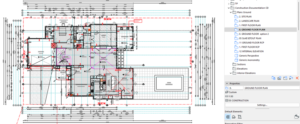

Screen images of Project Map and View Map will help
Nc2rnL

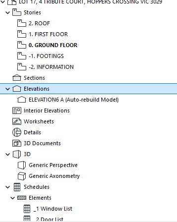

Hi Barry, thanks for the response. Yes it happened when I placed the detail marker on one elevation and noticed every elevations and sections I did before was gone. But the elevation/section marker is still on plan. I am confident I did not delete the elevations and sections. Hope this screenshots can help. Thanks, Barry.
AC28 PH / LEGIONPRO5 / 13th Gen Intel(R) Core (TM) i7-13700HX 2.10 GHz / 32.0 GB RAM
Strange.
They definitely don't seem to be in the list.

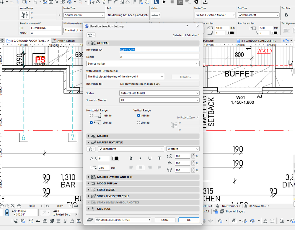

What does it show when you select one on plan and open the settings.
Nc2rnL
Hi, Barry. I've selected the settings of one of the elevation markers. I had an old file, and I've attached a screen recording of the strange happening of wiping the elevations and sections. Have a look into it. Thanks!

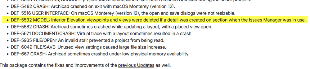

First check that 24 has the latest hotfix installed.
It should be builld 7000 and there is a security update for Windows machines as well.
I did see a similar issue was fixed in build 7000.
