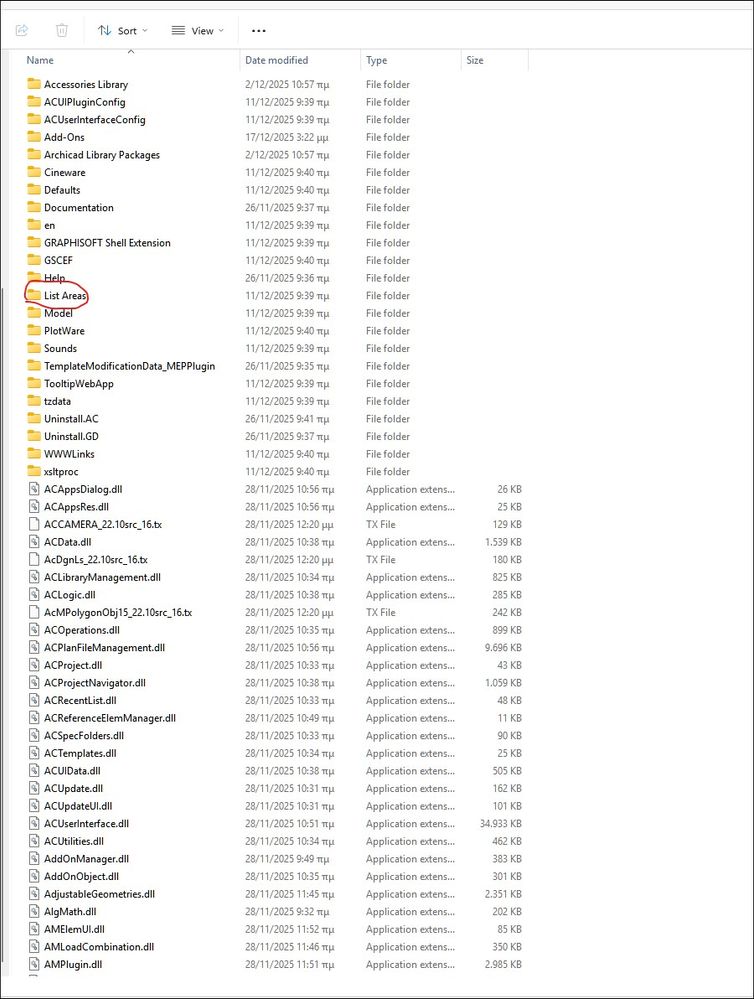

Just to inform users who search the current addon, that Graphisoft has released this for all versions, and finally for INT version, since Archicad 28. The  thing is that it is installed (folder name "List Areas") in the main installation folder of Archicad so you have to load it manually or just copy it in the addon folder.

Barry the addon is installed in the Archicad folder when you install the program. It is not somewhere available to download.
