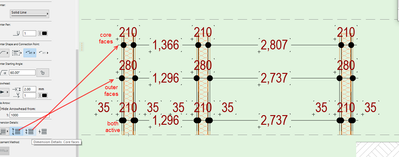

Hello,
Our design & construction documentation team has found that dimensioning in sections has become very tedious as we have to manually select each core face on each wall (we use complex profiles for the majority of our walls), and in plan it will select them without issues. The dimension tool will grab our composite walls/slabs etc. in section without issue. Not sure if this has anything to deal with our profile setup (snip of that included below) themselves, but it used to work previously (same complex profiles) with relatively no other issues. Link to video of the issue is included below.
While this issue causes for a minor inefficiency in production by having to manually select each point, the bigger issue is that the dimensions previously would be associated and move with the wall, whereas now the way we have to select them, they seem to not be linked to anything and remain in the same point on the view when the wall moves.
Section Dimensioning Issue

Hi @Lexi Szymo , you are right it works only in plan but in section I found it can only snap to outer faces of the complex profile and after placing the whole dimension line you can move dimension points manually to the desired core, don’t worry it’s associative dimension.

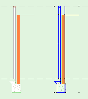

As you can see in this image, a complex profile wall can include footings, eaves lining and wall plates.
And they can be stretchy in all sorts of directions with modifiers.
So I assume that is why the dimensions can not lock onto them.
Add hotspots to the profile as you have discovered (although they do not move with modifiers as you stretch - but will move with the wall if you drag it).
