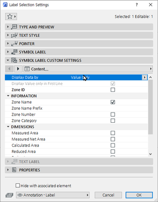

Export label to dwg. Is this a bug?
주방 = kitchen is TEXT
The rest are labels.
옷장 = dress room is label
I looked at the mtext value with the autolisp function.

Is this a bug?
AC27 on window 11
5 Replies 5
Noemi Balogh
Do you use the Archicad 25 zone label here? Or which label is this?
It helps the community to understand better what your issue is, so we can give you better advice.

LeeJaeYoung
I have another question, can I do it?
A question about Archicad's policy in Korea.
AC27 on window 11
LeeJaeYoung
On the left, 3 spaces have been erased.
If you export the label, you will get a blank space.
AC27 on window 11
LeeJaeYoung
I wonder if you guys used code 3?
Lisp, which removes whitespace from Mtext used by autolisp, doesn't work either. It works only after clicking once on the Mtext you created in CAD.
