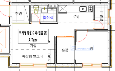

주방 = kitchen is TEXT
The rest are labels.
옷장 = dress room is label

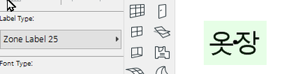

Do you use the Archicad 25 zone label here? Or which label is this?
It helps the community to understand better what your issue is, so we can give you better advice.

AC27 on window 11
On the left, 3 spaces have been erased.
If you export the label, you will get a blank space.

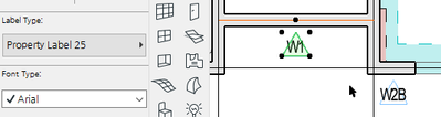

I wonder if you guys used code 3?
Lisp, which removes whitespace from Mtext used by autolisp, doesn't work either. It works only after clicking once on the Mtext you created in CAD.
This is original dxf code
(3 . "\\A1;{\\W0.750000x;\\pqc;\\pt0,76000;\\f나눔고딕|b0|i0|c129|p50;W2B\\f나눔고딕|b0|i0|c129|p50;\\A1{\\H.66x;\\S^ ;}\\f나눔고딕|b0|i0|c129|p50;\\f나눔고딕|b0|i0|c129|p50;\\A1{\\H.66x;\\S^ ;}\\f나눔고딕|b0|i0|c129|p50; \\f나눔고딕|b0|i0|c129|p50;\\f나눔고딕|b0|i0|c129|p50;\\f나눔고딕|b0|i0|c129|p50;\\f나") (3 . "눔고딕|b0|i0|c129|p50;\\f나눔고딕|b0|i0|c129|p50;\\f나눔고딕|b0|i0|c129|p50;\\f나눔고딕|b0|i0|c129|p50;\\f나눔고딕|b0|i0|c129|p50;\\f나눔고딕|b0|i0|c129|p50;\\f나눔고딕|b0|i0|c129|p50;\\f나눔고딕|b0|i0|c129|p50;\\f나눔고딕|b0|i0|c129|p50;\\f나눔고딕|b0|i0|c129|p50;\\f나눔고딕|b0|i0|c129|p50;\\f나눔고딕|b0|i") (3 . "0|c129|p50;\\f나눔고딕|b0|i0|c129|p50;\\f나눔고딕|b0|i0|c129|p50;\\f나눔고딕|b0|i0|c129|p50;\\f나눔고딕|b0|i0|c129|p50;\\f나눔고딕|b0|i0|c129|p50;\\f나눔고딕|b0|i0|c129|p50;\\f나눔고딕|b0|i0|c129|p50;\\f나눔고딕|b0|i0|c129|p50;\\f나눔고딕|b0|i0|c129|p50;\\f나눔고딕|b0|i0|c129|p50;\\f나눔고딕|b0|i0|c129|p") (3 . "50;\\f나눔고딕|b0|i0|c129|p50;\\f나눔고딕|b0|i0|c129|p50;\\f나눔고딕|b0|i0|c129|p50;\\f나눔고딕|b0|i0|c129|p50;\\f나눔고딕|b0|i0|c129|p50;\\f나눔고딕|b0|i0|c129|p50;\\f나눔고딕|b0|i0|c129|p50;\\f나눔고딕|b0|i0|c129|p50;\\f나눔고딕|b0|i0|c129|p50;\\f나눔고딕|b0|i0|c129|p50;\\f나눔고딕|b0|i0|c129|p50;\\f나눔고") (1 . "딕|b0|i0|c129|p50;\\f나눔고딕|b0|i0|c129|p50;\\f나눔고딕|b0|i0|c129|p50;\\f나눔고딕|b0|i0|c129|p50;\\f나눔고딕|b0|i0|c129|p50;\\f나눔고딕|b0|i0|c129|p50;}")
This is the dxfcode changed after clicking.
(1 . "\\A1;\\pxqc,t0,380;{\\W0.5625;W2B\\H0.66x;\\S^ ;\\S^ ;\\H1.51515x; }")
Value is W2B
