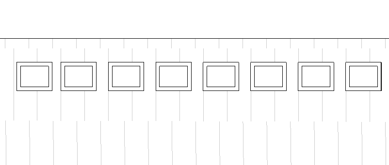

I aligned texture in 3D, but in 2D it is still not matched. How can I align it also in 2D elevation?

Try inverting the wall reference line (you might need to undo/reset the align 3D texture)
