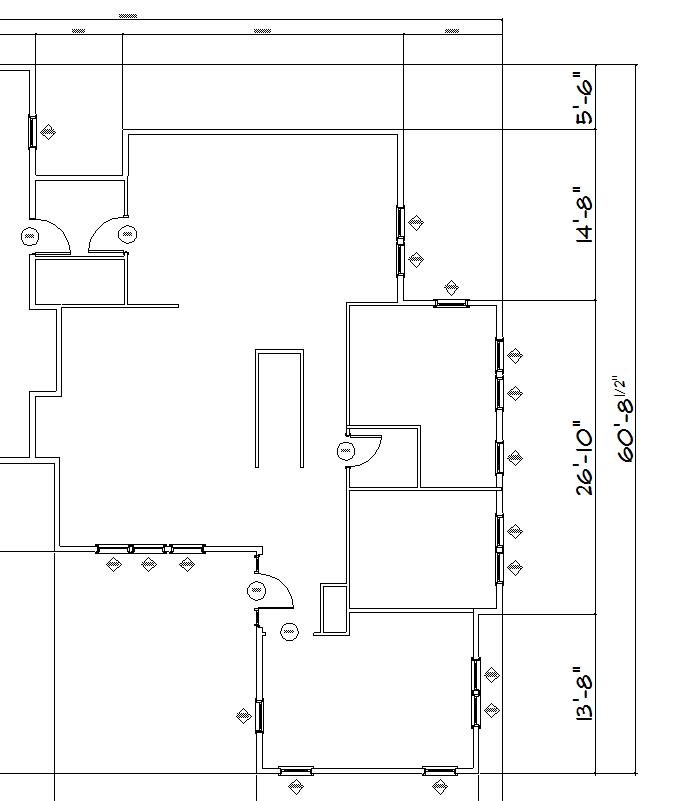

Why don't these two dimension chains add up?
There are no fractions in it, the overall dimension should not have any either.
Yes, I have checked the obvious settings. All are set to max. (1/64")
Any ideas?

Steve,
Can you upload a file containing this dimension chain and the associated building elements?

Steve Jepson
this is it. I deleted the windows and doors to get the file small enough to post.

And you said you checked all the obvious settings!
Seriously, did you set your Dimension preferences to 1/64"? This is different than your Working Units.
