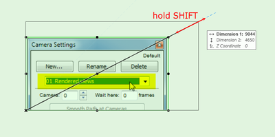

Shift for Proportional Scaling
SHIFT key doesn’t work like every other design program to scale proportionally without distortion. I’d like to use SHIFT to proportionally make things bigger and smaller in Archicad, mostly when working on sheets and Documentation it seems would make sense. Dragged in images, placed drawings, that sorta of thing, not neccessary drawing or modelling. Wonder if I’m missing something here? Any ways, either part of Archicad, or creative hacks through MacOS to adjust how this works?

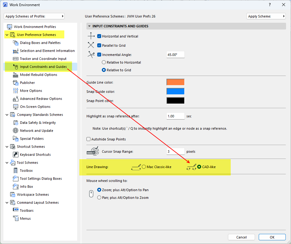

Click To Pick Up + Click to Place
Can you turn off the click once to pick up and once to place? I'm still very used to just Click, Hold, Drag, Drop without having to Click to place in the final location. Trying hard to rewire my brain but can't yet it seems.
  • So click something to select it and drag somewhere, and wherever you let go of your mouse is where the thing goes?
  • Currently for me you have to click where you want to put the thing a second time.
  • Not good for some situations, but in other documenting flows it’s nice.
As you stretch the corner node, you will see the origin is the diagonally opposite node.
Drag in a straight line joining those two nodes and hold the SHIFT key.
It will constrain to proportional.
If you have snap guides on, you will see a blue snap guide to follow.
Check your Work Environment settings.

Solution
Drag it larger and hold SHIFT.
It will lock to that snap guide and now you can stretch it smaller too.
Once locked, you can stretch in either direction.
So interestingly couple observations here:
  1. Drafting I prefer to use CAD, like makes lot of sense for drawing stuff. But then for documentation and non-drafting I prefer Mac-Classic like flow, guess you can't have it both ways. So I don't know what to chose now.
  2. When I turned on the Mac-Classic option, if you move an object once it works, but if you move that same object again right after it requires you to do Click-Click to drop the object, not sure why.

Quick follow up here for scaling. I'm notificing that some things still seem to be off. Any feedback would be greatly appreciated, thank you!
Can't get it to work with making images smaller, maybe it only works when making bigger, but this would be very weird. Any ideas what's going on here. I've recorded a screen video to share so you can see, with voiceover audio explaining what is happening.

Solution
ethanbodnar
Super strange. Guess that's just the way it is. Thanks for confirming what I was seeing Barry. I've never used a professional design app that forces you to make something bigger to then be able to make it smaller. Such a weird behavior that makes no sense, but maybe there's some legacy reason or CAD related reason that I'm just not seeing.
Archicad v26, MacBook Pro, MacOS 13 Ventura, AMD Radeon Pro 5500M 8GB, RAM 64GB, Non-SSA, Twinmotion User
It is just the snap guide does not exist until you drag the mouse beyond the corner node you want to stretch.
The opposite corner becomes the 'origin' of the stretch.
If you drag smaller, there is nothing for the snap guide to lock onto to be created - so you can just stretch in any direction - no guides to follow.
But if you drag out beyond but close to the node you are stretching, a snap guide will be created from the 'origin' through that corner node.
The snap guides are intuitive and will be created based on other nodes, intersections and other snap guides.
You can now lock to that snap guide ad stretch in either direction along it.
ethanbodnar
Thanks for breaking it down, makes more sense!
Kinda seems like other design programs are let you scale images proportionally as a seperate feature, whereas Archicad is using the snap guides for everything, since that's already part of the program workflow.
