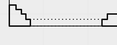

If this option in the MVO is on (show hidden lines under a slab for a beam)

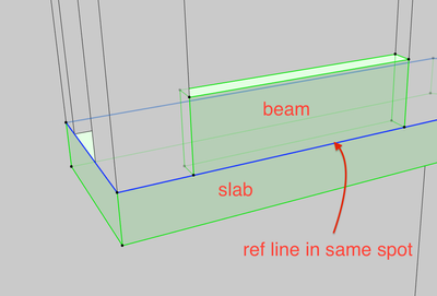

and you place a beam with its reference line on TOP of a slab like this:
your graphic output in the plan will be wrong:
Ouch! This should have been a solid outline...
Looks like an easy fix however and somebody just got an IF clause wrong.

I see hidden in INT attributes represented by dash lines while what you show is dotted lines so it may be something related to the beam display or GO.
AC 28 INT 3110/WIN 11
Thanks for your comment, but no, there is no GO involved here 😉 The linetype comes from the beam settings themself.
It's a bug, just as I stated. You can try it yourself!

This probably really is a bug.
If the reference line touches the top of the slab or is below the top of the slab it will display as hidden.
The reference line axis can either be a top/middle or bottom, it doesn't really matter. It only matters if it touches the top of a slab or is below it.
Here's a quick comparison. It's definitely not the expected behavior.
This feature is from AC23. Hopefully someone at Graphisoft can look into it.
