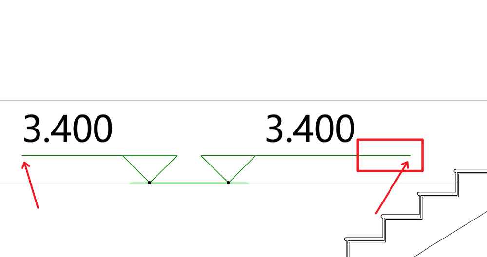

Can I change the dimension tool's line length?
William Yan
Hi everyone, I have a question, the dimension tool in elevation is not good looking when the line is on the right side (the line on the left side is OK). It is longer than the text. Can we make the line align with the text?
AC 26 5002 CHI, Windows 10
1 ACCEPTED SOLUTION
Solution
That one particular marker type seems to have a small extension to the right side of the line past the text.
It does move when you move the text.
If you change to any of the other marker types, the line ends exactly at the end of the text (and also stretches as you move the text).
I can't see any way of adjusting this - I think it is hard coded in the program for that marker type.
I would say it is a small bug which you can report to your local Archicad distributor if you are truly 'bugged' by it (sorry, bad humour).

Haha, I am truly "bugged". 🤣
OK, I will report this to Grahpisoft. Hope in a few years later, they can fix it.
Thank you very much!
