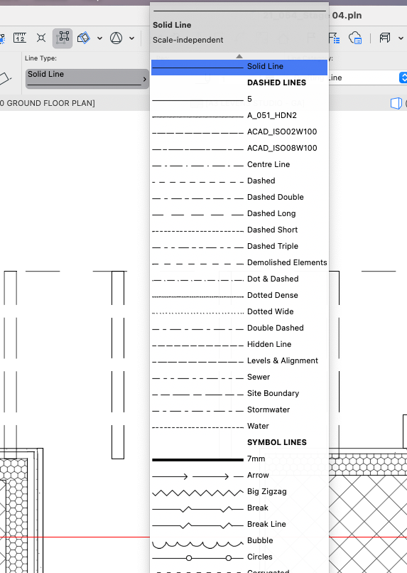

Can't change line type - locked with 'scale independent'
Hello,
See screenshot - I'm definitely missing something very obvious as I used to be able to change this without issue?
How do I change the line type freely?
Thank you.

Assuming you are using Archicad 26 on macOS Ventura, this is a known bug. You can use the arrow keys to change the selection.

Are you on macOS Ventura? This is a known bug. You can use the arrow keys on the keyboard to change line types.
See: https://community.Graphisoft.com/t5/Setup-License-articles/macOS-13-Ventura/ta-p/359447
