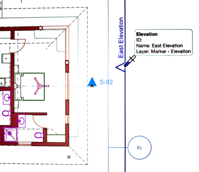

Niranjan Das Sharma
Try this. Set one elevation as per the elevation setting you wanted, save. Now go to plan and use the eye dropper to pick settings from the corected elevation marker and inject it to all the other elevation markers you wanted to change. It worked for me.
