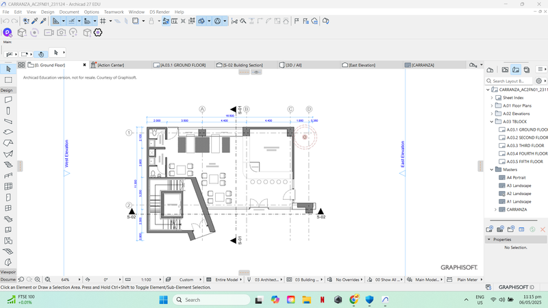

Why are some elements missing when the drawing is placed in the master layout?

That looks more like a View issue than a Master Layout issue.
The Layer Combination shown in your top screenshot of your floorplan has a Custom layer combination so I would assume that it does not match between your floor plan and your layout. Ideally you will be using a NAMED Layer Combination. If you right click on the View that you have placed on your Master Layout you can "Open Source View".
