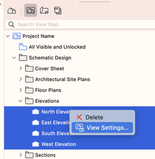

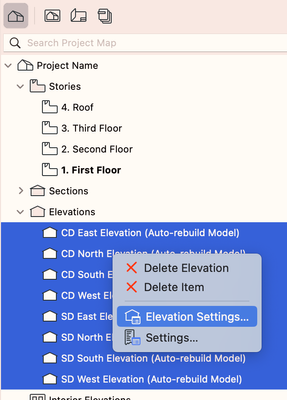

I can select Elevation Settings for a folder only from the Project Map (viewpoints) - and not the View Map (which has a different icon on 27 Mac) - whether a folder or an individual elevation in the View Map.
For an actual elevation, it is bizarre.  I can select multiple elevation viewpoints in the Project Map - and right click still offers Elevation Settings...  But, while selecting a single elevation in the View Map folder will offer Elevation Settings, selecting multiples does not...giving me only View Settings in that case.
And even stranger (?) behavior (27 build 5003) ... I can select Elevation Settings for the parent folder - cloned or not - in the Project Map and, e.g., turn on shadows.  But that has no effect on the elevations contained in the folder - so I'm not sure what the point is for a non-cloned folder.  I have to shift-click to select all contained elevations and then right-click select Elevation Settings and then I can change the settings for all of the contained elevations.
Actually, I am seeing the same thing.
If you do select multiple elevations in the view map, you do not see the 'Elevations Settings' option - only if you select the cloned folder or select the view points in the project map.
