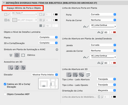

I'm the only one who needs a separate box of Minimal Space for Doors, and another for Objects on MVO? We have specific local rules for door accessibility, and we need to produce a floor plan with minimal space only for doors. So simple, but it will never come! : (

I think you may not be using the new 28 Global Libraries.

@Vinicius Lima wrote:
So simple, but will never come! : (
I am not sure if I am really allowed to say this, but, it is separated in 28.
You know what is weird... I'm the responsible for the online Template BRA here in Brazil, and didn't notice that in TP 🙃

I was migrating my projects to AC28 just this week... Than, I opened the MVO to see this separation, but... it was not there! Sad, you gave me hope @Barry Kelly

Solution
OK, you hit it and many thanks for that!
But, for a BIG change as these one (libpacks - Global Library) GS should delivery more information about it. You go in the Archicad channel on youtube, type "libpack" in videos search-bar, and nothing comes out... Honnestly it shoud be given a manual explaining all diferences between the two library systems and also, why they have changed. It's not even in the pop-up window with new Archicad features...
I will let this link to others with same issue:
https://community.graphisoft.com/t5/Libraries-objects/Archicad-28-Migration-Converting-from-Monolith...
