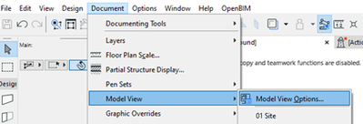

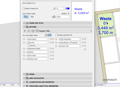

I'm trying to create zones in my project, but I can't seem to be able to get my zone stamps to actually display what I want them to. Whether I use scale sensitive or uniform stamps, I get a lot of useless extra info that I didn't ask for, and that, if I look at the preview, I shouldn't be getting. I can edit the zone stamp after I've placed it, but the changes that I try to make before placing the zone don't apply. I just want the name and the area.

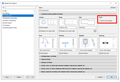

if you haven't changed the Model view options, then the Zone stamp you are setting in the zone will not show up
update your model view options...

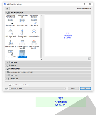

what you may be seeing in plan is a zone label

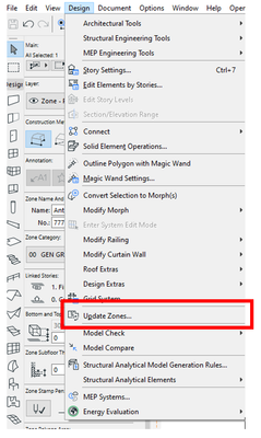

you may need to update the zone as some functions are not automatic...
