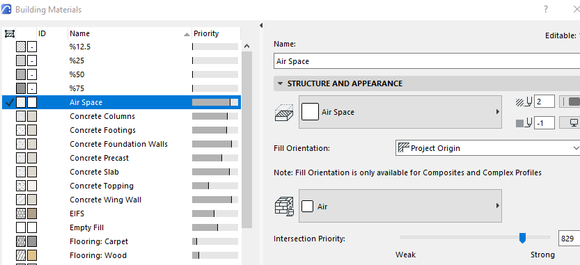

I appreciate any help in advance. I am going to have a hard time explaining this one so I made a PDF to show all my settings.
For some reason only my party wall complex profiles are showing up on my plan as white all of a sudden. They were previously working fine. It is almost as though they went and disappeared and not in a way I can find it again...
First I double checked to make sure the building materials weren't accidently changed. These settings looked fine. This profile is using the same building material as my exterior walls which show up the way I want them to.
Next I thought maybe I messed with a graphic override setting by accident. These settings were fine as well. I tried removing all overrides, but it didn't matter. I am able to override them to grey if I so choose but this will override all of the components in the complex profile and I do not want this. Although this has been my temporary fix for the file.
I also checked within the Wall Settings to make sure I did not have an override cut fill selection. I do not. I actually tried to add on an override fill here instead of using the graphic override setting. It did not matter what settings I picked in the wall specific settings, it would still show white.
I am baffled and have spent way too long trying to figure it out myself. I could try to remake them, but I didn't' want to start over. It would be good to know for the future as well, what exactly caused this or if there is an easy fix.

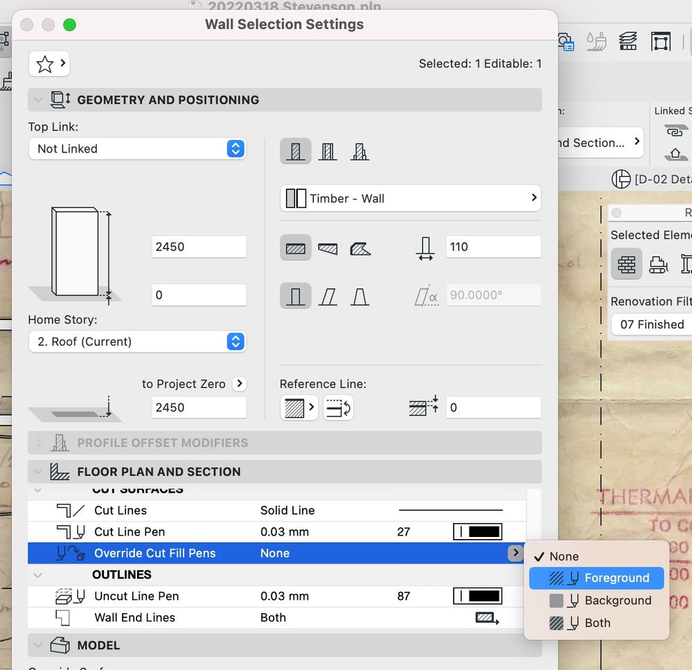

I had same issue, fixed; In wall settings, under Cut Surfaces, change the "Override Cut Fill Pen" to "None"

Hello, the solution was that the building material had somehow ended up as "air space" which has a plain white fill causing the walls to appear white. Sorry for the delayed update, hopefully this helps anyone else that has issues.
