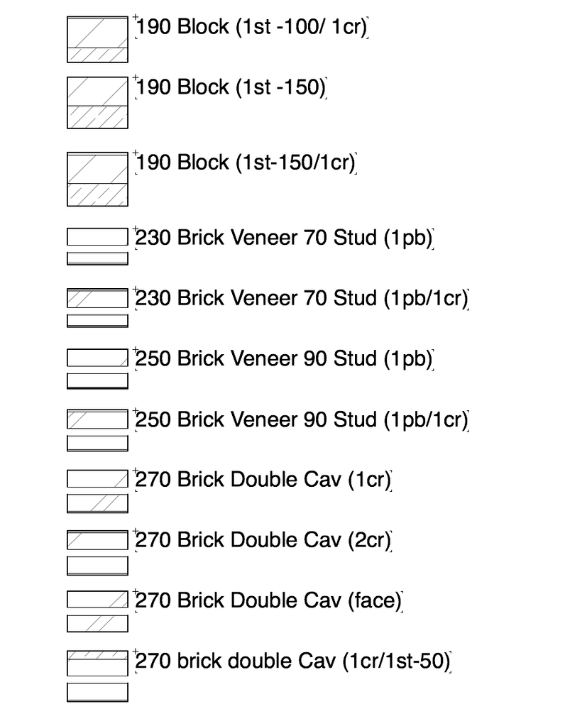

Is there an easy way of creating a graphical legend showing all the composite types (all the composites listed under Attribute Manager)?
ie. A legend or schedule that lists/ illustrates the following:
1.Composite visual Plan/Section drawing
2. Composite Name
3. Composite Core thickness
(See attached Screenshot)
Cheers

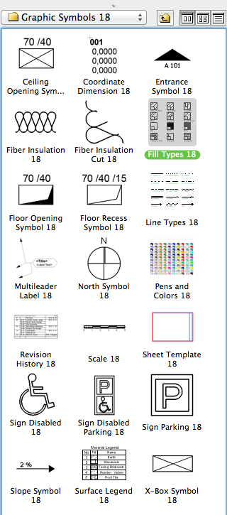

There are objects in the standard library you can place to show all Fill types, Line types, Pens and colours, and now in 18 Surfaces, but nothing for composites. I wonder why not?
In GDL it is possible to REQUEST pens, fills, line types and surfaces/materials but not composites.
It might be because composites are made up from fills, lines (pens used to be part of the composite but are now part of the building material).
Plus in GDL it is possible to place a polygon that has a certain fill and pen colour or a prism that has a certain surface - which is what those objects do that you mentioned.
But it is not possible in GDL to place a composite.
