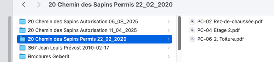

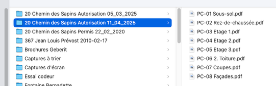

I assume your Layouts are organized in folders, so you have to reserve it to work on those layouts.
Name the folder with the date, you will modify it each time you publish.
In the publisher set add the folder with the "add shortcut" button, the publisher folder will automatically take the same name and be populate with the layouts.
The publisher set save directory has to be set once to the root directory where you want the PDF Folders to be saved. No need to change this after.
When publishing, if the date stamp folder of the publisher set doesn't exist it should be automatically created, if it already exist it will be populate with the pdf files of the selected layouts as you can publish all the set or just selected elements in it. That means each time you change the date in the layout folder name, the publisher set folder name will change and a new folder be created on the first publication.
 Now for the scaled PDF, duplicate this publisher set, change the publishing to printing and choose to print in a PDF file on MacOs, or choose a PDF printer on windows, you can then set page size and scale. Don't forget to direct that printing work in an other folder. All that settings are stored with the project file.
If you have some you often use like 50%, 200% create a publisher set for each.
