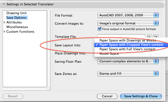

Create dwg's from layout?
We need to send our client all of our drawings in dwg format. I know I can drag all the details, plans, elevations etc. into the publisher and do it that way, but some of my drawings have "extra" stuff in them I do not want to include. Can I simply publish a sheet/layout as a dwg, and have it incorporate the lines/fills that way? Does it work like that?

Create the dwg from the layout.... but experiment with the "Save Layout into:" choices in your translator settings.
Someday I'll get it dialed into my office template.

Ah, good, it can be done.
