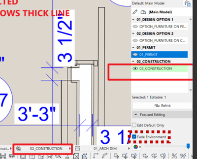

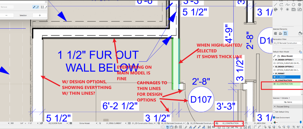

DESIGN OPTIONS QUESTION:      I have just started working with the new DESIGN OPTION feature in AC27 and have a graphical issue.  When the 2D or 3D objects are on the Entire Model the pen Line weights show correctly.  However, when I put something on a Design Option, the line weights are all consistent and appear thin.  If I select a wall with a thicker lineweight, you can see it highlight w/ a thickness, but looking on screen, everything is thin.  I have checked all my filters and nothing seems to effect this but the design option.   Is there a setting for show line weights for Design options?  or am I missing something?  Please see attached snapshot:  Thank you!

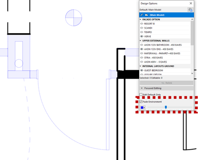

The "Fade Environment" setting will display the design options elements in hairline
Untick it to get the correct lightweight.
this is just onscreen display(does not effect output)
you can also use the slider and color picker to effect color/transparency of design option elements
I hope this helps.
