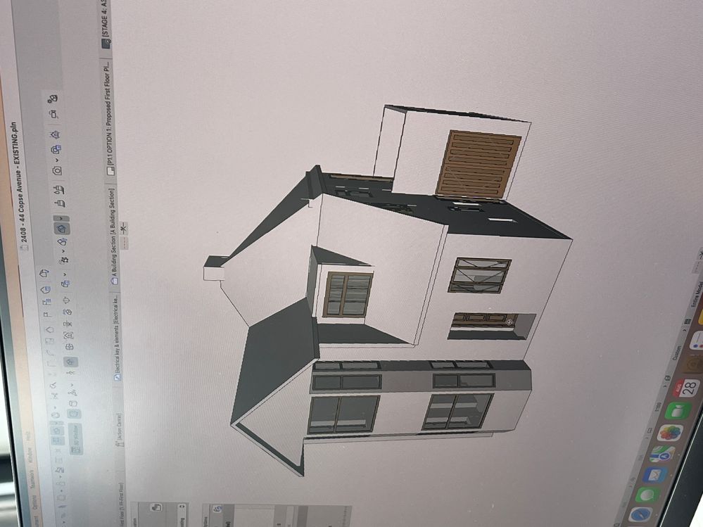

Hello all,
I wonder if if anyone can help me with the following.
I am having an issue with a demolished roof showing and cutting through my proposed new wall in 3D. I am unsure as to why this is happening. I have tried modifying the building materials - intersection priorities and that does not solve the issue.
See below attached for images.
Thank You!
Operating system used: Mac Intel-based
Setup info provided by author
2 Replies 2
JAStudio
Same problem. Have tried several work arounds, but none work. When I move the existing roof that is going to be demolished out of the way, the wall trims properly to the new roof. But when I drag the existing/to be demo's roof back in place the cut from it appears in the new wall again.
Matthew Wood
Hi, I have found a solution to this problem - it was to do with the renovation filters for demolition not having the right boxes ticked. Under "existing elements" i had the "Do not Intersect" unticked which I have now ticket and has solved the issue
