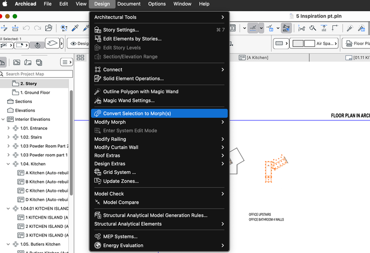

Hello, currently working on project that will need kitchen design options. I understood that there is some great tool to do it , assuming it is better than copy-paste as I did it previously. Anyway! can't find the tool at all. I have archicad 27, I tried searching "design options/design options manager/even just option..." and it's just not there. I am not kidding. Or am I blind?
Operating system used: Mac Apple Silicon 14 Sonoma
‎2024-07-07 07:51 PM
If you migrated your Work Environment from 26 it will not show in your Menus.
Switch to one of the defaults for 27 and it should be there.

‎2024-07-08 12:57 AM - edited ‎2024-07-08 01:12 AM
EDIT: it worked. However I lost all my working environment setting with all my on-screen tools, thats pretty annoying.... Thanks god I saved it. Also once I put it back to my setting, it's not showing. Sorry but this is not normal @archicad the more I work with this software the more I hate it.

If you are using an old custom Work Environment, then it will not know of any new commands and will not show them.
It will assume that your custom WE is how you want it to be.
If you use a new 27 default Work Environment, then it will not know of your custom settings.
So you can add the new commands to your custom WE.
Or you can add your custom settings to the default 27 WE.
Unfortunately there is no easy way to merge the 2.
The WE is divided up into sections, so you can swap those individual sections.
But is still doesn't help with new commands in toolboxes, menus and keyboard shortcuts.
Fortunately you can see a list of all new commands, but this are only the new ones since 26.
If your WE originates from say version 24, then there will be a lot of other new commands that are not considered as new anymore.
‎2024-07-08 04:53 AM
It is standard normal practice to re-create your W/Es yearly due to the updates.
At a minimum you will always need to recreate (or edit to add the new commands as @Barry Kelly indicated) the one for Menu's. All others can be imported from previous years without much issues. Shortcuts is another you need to look into to check if there are changes.
