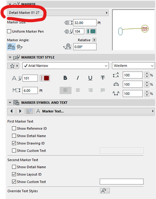

Hello, in the Marker detail , why can`t write the ID layout in the Second Line?
Operating system used: Mac Intel-based 14

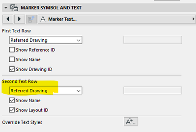

Looks like you have it set to "Custom". If you change it to "Referred Drawing" the layout will show.
If you would like to enable both, you may need to change your marker Type. "Detail Marker 01" allows both to be enabled at the same time.

Thank you for the answer, also i change the "reference Marker to", selected Drawing and there it works!
