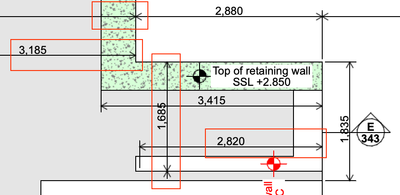

Dear Graphisoft,
When can we reasonably expect dimensions to be stable in our drawings?
I have today opened up floor plans to be issued urgently following the 27.1 update & found most of the linear dimensioning to the outside face of the walls has arbitrarily abandoned the wall thicknesses in favour of base lines and single faces. Upon trying to restore the dimensions numerous wall thicknesses reappeared in the same dimension and in one case an adjoining dimension line also restored itself.
Seriously, why are you bothering with structural & MEP system development & time wasting experimental features when you have primary CAD functionality which regularly fails at the most basic level? If Archicad can't reliably do these simple tasks then why would any discipline use it!
Hacked off again.
Original layout
After update

It seems the dimensions were associated to the correct edges or nodes and now they are not.
What has affected that I don't know.
It can't be partial structure display because the entire dimension would have gone.
It can't be renovation filters because you can't apply reno status per skin.
I don't even think wall skins are involved here anyway.
But back to my point.
Even if we could auto-dimension, what is stopping the associativity from disconnecting as it seems to have done here.
Whether the dimensions are place manually or automatically, I don't think it would make any difference here.
The question is, why have these dimensions suddenly decided to associate to only one side of the walls?

I guess there might be a clue in the List of Improvements contained in update AC26UKI 6002...
  • DEF-8442 New Dimension point could not be associated to skin’s edge on Floor Plan.
I don't know what goes on at GSHQ, but I assume what I saw was in some way related to some coding cross pollination.
