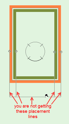

OK that all looks good.
So now if you click where the hammer is, you should get your dimension.
But as you say you are not getting the placement lines as you choose where you want to place the dimension.
I am not sure why you would not be seeing these lines, but you do see the hammer cursor.

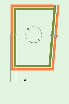

Actually I just had a thought.
The walls you are dimensioning are not exactly vertical.
I have exaggerated the problem here.
You can see one wall is not going to dimension, because it is not perpendicular to the dimension.

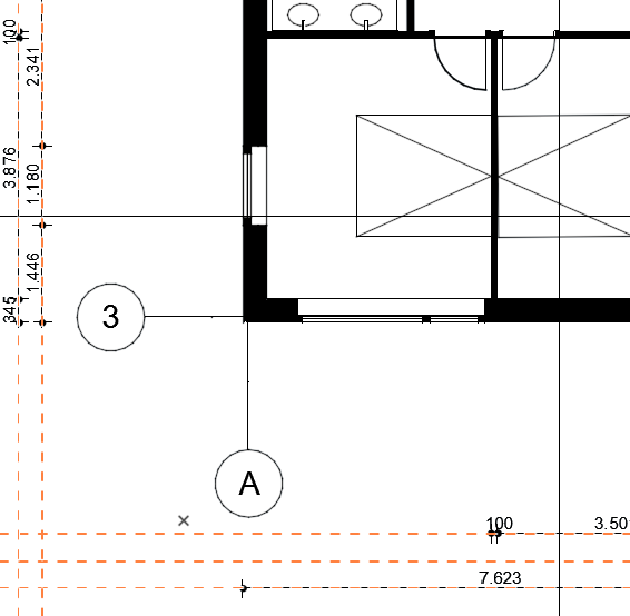

hay there,
i ve got the same problem. but as far as i can see do all the walls have a angel of 90 degrees. in the whole document i can put the right dimensions, just a spicific part not.  The specific place at the bottom betwee A and |100|. i get the placement lines and the little hammer. do you have any sugestions?

So, you click on the side of the walls as I show here.
You should get a round dimension market (target) on each side of the wall.
Then you double lick to bring up the hammer and place the dimension.
If you only get one dimension (the 100mm) then the walls are not vertical or parallel to each other.
See my previous post.
They only have to be off by the smallest amount not to work.
