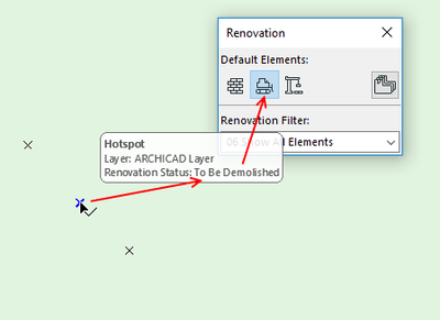

Maybe it has something to do with renovation status?
You can't set it or change it in the hotspot settings.
But they will be set according to the renovation palette settings when you place them
You can also change them via that renovation palette.

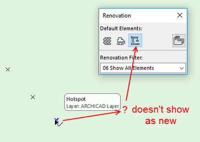

I don't know why 'New' does not show in the info box.
This was in version 25.
