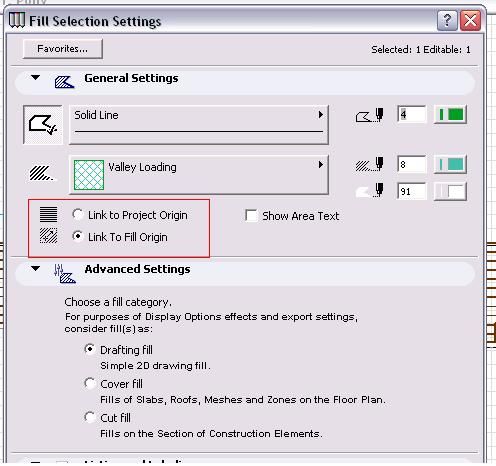

I see the "Link to Fill Origin" under the general Tab. I do not "see" the Fill origin when this is checked. I thought that this only changed the Fill Patterns reference.
Jay
check your display options to see if Fill Handles are set to Show or Hide
woodster
