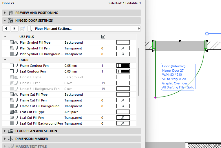

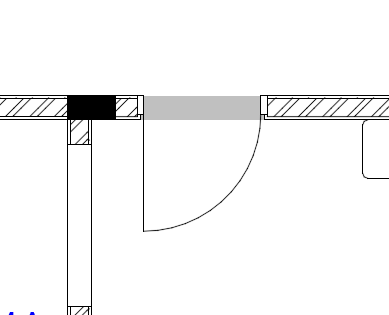

Hey there! i'm currently find a way to remove this gray bar under the door symbol, can somebody point me how to remove this? i want my documentation drawing to be clean and Black&White. Thanks!

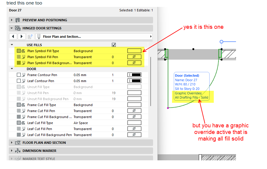

Yes it is these settings.
But you have a graphic override that is making all fills solid.
You either need to turn that GO off or add a criteria in the GO settings to not include the doors.

Look for the fill and pen colours in the '2D representation' settings of the door object.

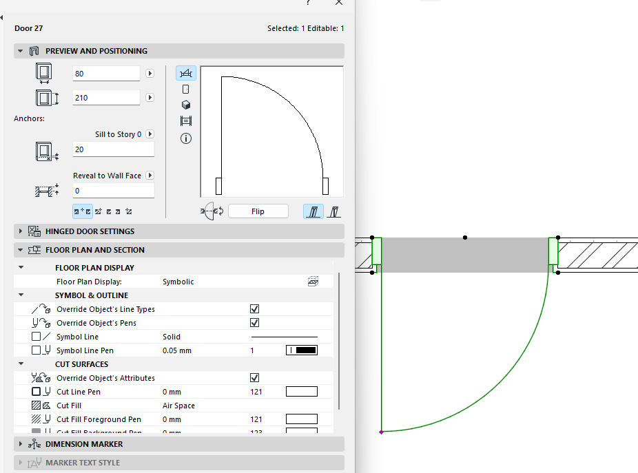

zidaneasyad
am i doing it right? doesnt seem to change anything
zidaneasyad
tried this one too
zidaneasyad
OMG Thanks! it works, u r the best!
