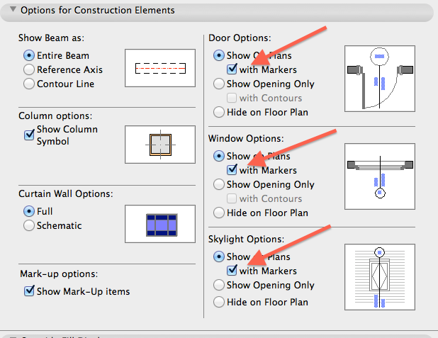

Model View Options have an on/off setting for door and window markers too. Check there. Remember to "Store As…" if you make changes and overwrite the previous saved MVO
