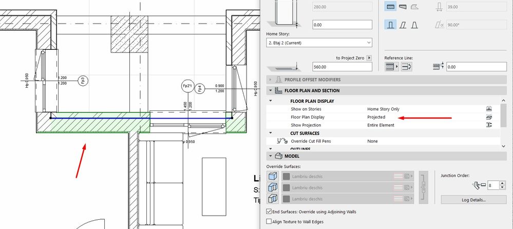

hi and thanks...had a similar problem and partly fixed it with your fixes. but not entirely. in wall settings/ floor plan display/symbolic cut. problem is when you try to select it on floor plan with tab it doesn't work. fortunately i had a marker and use it to select it
bennychrist
Check this one. Document>Floor Plan Cut Plane.
