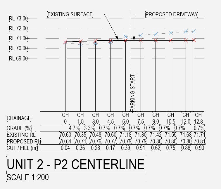

Hi All,
This may not be an Archicad specific question, I would understand if this post gets dumped.
I am wondering if anyone knows:
- Is there a way to generate a driveway long section, that would give the RLs of both the existing ground and proposed ground levels, with the proposed driveway gradients (or some of these to minimize my manual input), or
- Of a compatible software, that I could export my 3D model into and have this capability>
At the moment to create my long sections it requires FULL manual input, and then if there is a change to any levels, I have to re-do this.
Thank you,
Chris
