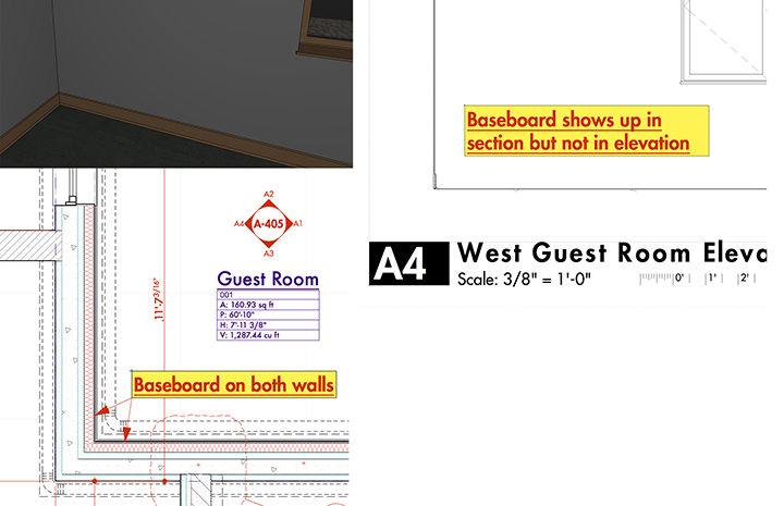

I have noticed that a baseboard element (complex profile) shows up in plans and 3D views, but not on the interior elevations. Per the image, the baseboard cuts normally in section, but is not present on the elevation beyond. Same layer, same renovation status, etc. I even tried selecting the wall in elevation and pushing its display order to the back. I can't select it in elevation - it's like it's not there. It happens in other rooms, too: Invisible on the interior elevations.

Check your 3D in hidden line or wire frame mode to see if the actual lines are there.
If not then you will need to adjust your profile by making sure there are nodes on the fills at the locations you want the lines and then assigning different materials to any edges that are in line with each other.

Barry, thank you for the thoughts. It does not appear to be the same issue you had, and I did check to see if everything was there in wire frame. It looked correct, so I'm still trying to figure out why the element doesn't show in elevation.

It could be a problem with the Interior Elevation tool - never did like those so I never use them!
You say it works with a section - you'll probably find it works with a standard elevation as well.

Barry, good tip. The baseboard that didn't show up on the Interior Elevation view showed up as expected using the standard Elevation approach. This seems to be a bug with the Interior Elevation tool and I'll let Graphisoft know. Thank you.

Hi, this was an Archicad 17 bug that was fixed within the project of improvements of the interior elevation tool for ArchiCAD18. The workaround - as mentioned here before - is to use a regular elevation/section, and the bug has been fixed for ArchiCAD18.
