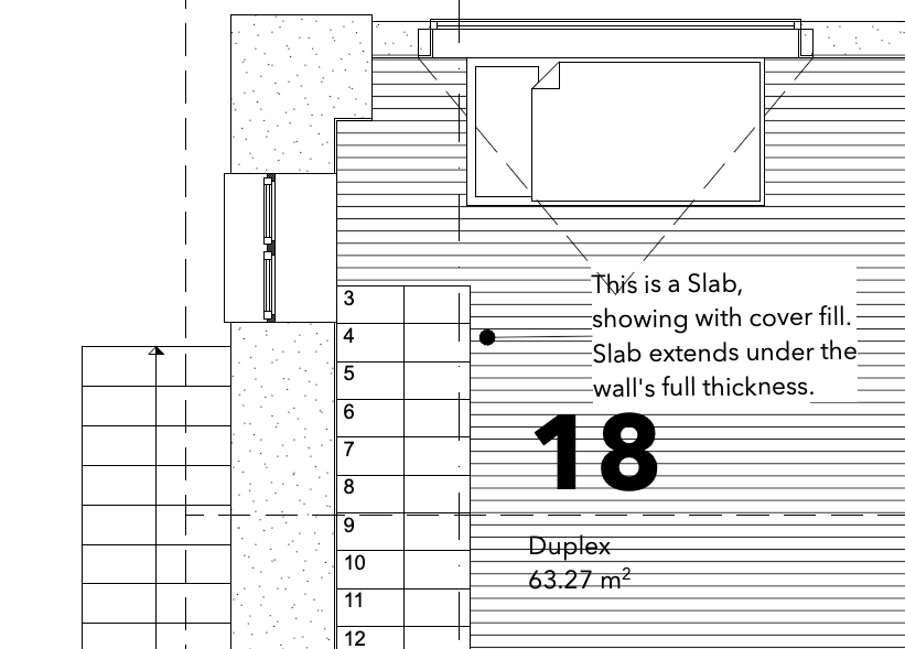

Before I apply the graphic overrides, the plan view shows correctly like this:

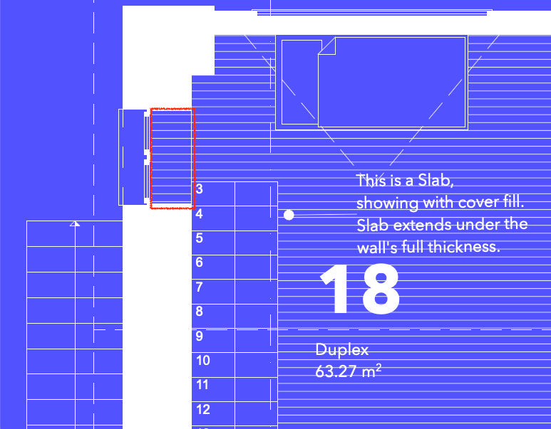

After I apply the graphic overrides, though, the slab shows through the length of wall where the window is, on the inside of the window (marked up in the red rectangle):
I have fiddled to no end with all the options I have thought of: cover fills/cut fills in the GO rules; in the cover/cut fills in the window and wall settings.
Any ideas as to what I am missing?

I have sorted this one. Has to do with which type fills are selected in the GO rule.
