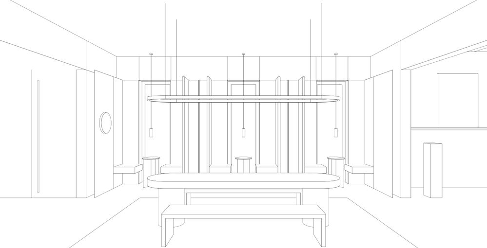

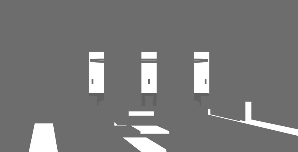

I need to export 3d views only countors and only shadows.
The problem with countours - is that despite the ways - its always bad quality, but I need to have it perfect in order to work with each line in Photoshop or in Illustrator.
And with the shadows - I havent found any way to export them.
Seems like those options are only possible in Sketchup.. (attached how I need them to be)

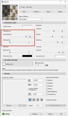

I think one way to do this would be to create a 3d document from your view. You would then create a worksheet from this 3d document, and open the newly created worksheet. You can then select all the lines and move it to the side or on another worksheet. Same with fills, you can filter the fills to select only the ones with gray tones (shadows) or white tone (building geometry). Then it's just a matter of exporting as a format that would be useful for you - dwg or ai.
Also make sure that your glass material is %100 transparent before creating the 3d document as it is crucial for having the shadows display properly.
