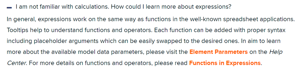

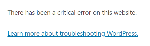

2. The FAQs page has a lot of helpful information, but I'm still none-the-wiser regarding expression syntax, STR functions etc. because when I follow the links in the FAQs item "I am not familiar with calculations. How could I learn more about expressions?" I hit a 'critcal website error'

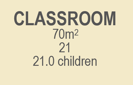

CONCAT ( STRCALCUNIT ( ROUNDDOWN ( {Property:Zone/Measured Area} / 3.25 m2, 0 ) * 1 m2 ), " children" )
The weird thing is, when evaluated, the property displays with a single zero-decimal place, eg. a room 7 x 10 I'd expect a result of 21.54 children.
The ROUNDDOWN expression evaluates as expected to 21, however the CONCAT expression evaluates as 21.0
@poco2013 mentioned last time "The zero will give you a integer value, but you will still get the same number of digits set in Calculation Unit" which seems to be what's happening with the CONCAT expression, but it's not clear why this isn't also occurring with the ROUNDDOWN expression.
Can you help me remove the decimal point and trailing zero? Changing the Calculation unit accuracy isn't a solution as I still want to see zone areas calculated to a single decimal place.

So ROUNDDOWN ( {Property:Zone/Measured Area} / 3.25 m2, 0 ) * 1 m2 ) gives you 21 as you want.
By multiplying by 1 m2, I think this is converting the number back to m² (a unit value) - (you divided an area by an area, so you will have just a number now as the result), which then forces you to use STRCALCUNIT to convert a unit to a string.
I don't think it is an issue with CONCAT changing it, as that is just joining two strings.
The STRCALCUNIT will convert a unit to a string using the calculation units, so that is where it is getting the decimal place.
You say you don't want to change the calculation rules.
So can you use just STR instead.
It may not work as you seem to be converting the number back to m².
Without setting it all up myself, maybe try this.
CONCAT ( STR ( ROUNDDOWN ( {Property:Zone/Measured Area} / 3.25 m2, 0 ) ), " children" )
