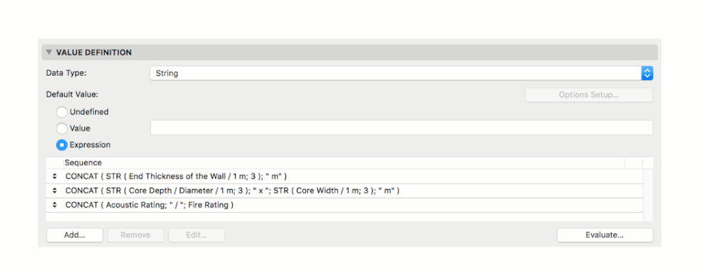

Expressions can handle multiple rows of sequences which refer to different types of elements. Each element will use only that sequence which includes relevant and valid parameters for that element type.
The algorithm will go through the list of sequences, using the one that is relevant to the element. With other words: the property will show content if the element fits the requirements of the expression.

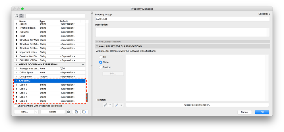

Go to Options > Property Manager.

  • I make the expression-defined property available for Door, Wall and Column elements.
  • I place the label on a Door element so Wall thickness, Core depth and Core width are properties that are not relevant, but "Acoustic Rating" and "Fire Rating" are properties that fit the requirements.
The algorithm sees the same. When it reaches a sequence, which includes relevant and valid parameters for that element type, it will use it.

A possible workflow could be to set up a Property Group in the Property Manager and create properties, specifically for labeling. We have to name the properties, but we have to keep in mind, they can describe different values sometimes even with different units. Consistent naming protocols should be used.

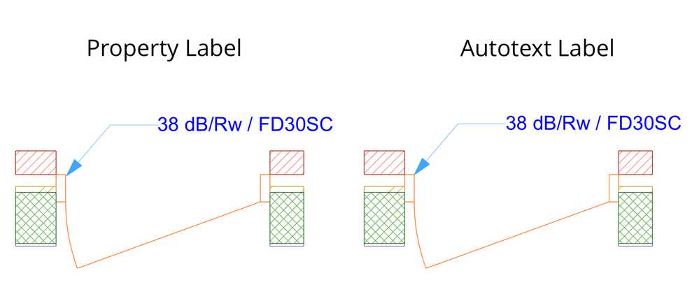

For example in a simple case like this, it's hard to tell what is what without entering their settings dialog.
But, the difference would be obvious, once we think of how expressions work and what we can achieve with the help of sequences. An Autotext Label is a great tool for documenting, detailing, to deal with large descriptions easily, keeping the specific information up-to-date and linked to the element and in simple cases this is the way to go. But, an expression defined property is able to hold this information on the element level, making it possible to export its value and to have it linked to the element.

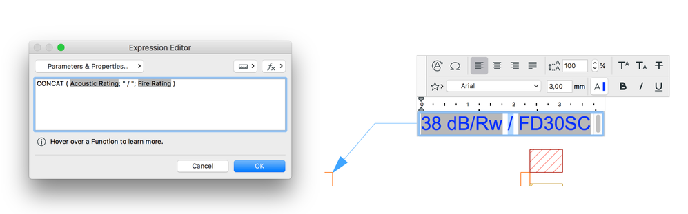

Editing an expression looks like the picture on the left, while editing the autotext is on the right:
It is also worth to mention that while an Expression can be edited centrally in the Property Manager, this process is much more elaborate with Autotexts.
If there is no other requirement, making a label for the acoustic and fire rating of a door could be easier with an Autotext label, but if we want to combine it with something, possible to read other element specific properties as well and to use equations, the Property Labels are the way to go.
