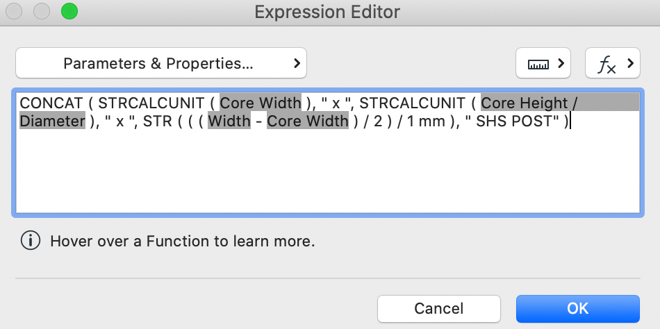

Kevin Lee
That does work 🙂
@Barry Kelly 😀
