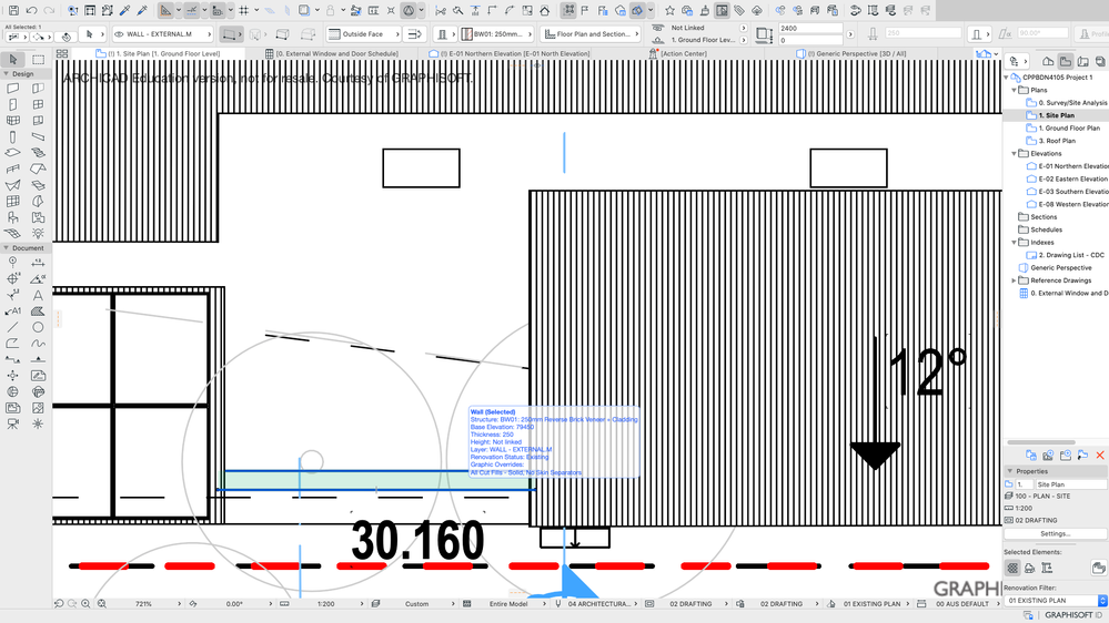

Hi there, Could you please assist me why this external wall is showing from the site plan? how to hide this?

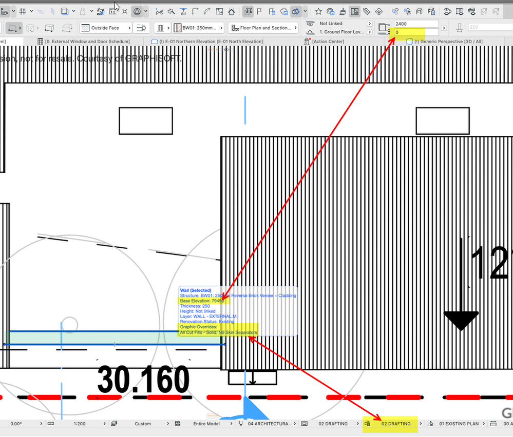

Strange, because what you see in the info box (base elevation and graphic override) does not match your settings.
I can't think why.
Actually I see now you are looking at the site floor plan and this wall is in the ground floor at zero base height to the ground floor.
Your site plan storey level seems to be 79450 below the ground floor storey (not sure why).
But not to matter.
Is that ground floor wall set to 'show on all relevant stories' and it actually has a base height a fraction lower than zero, so small that it actually shows as zero?
Try actually typing a base height of 0 or set it to show on 'home storey only'.
mthd

Thanks Barry and mthd, I just used display order option and then send it to back😊 and it worked.
